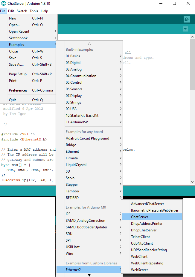

First update the Etherent2 library to the latest version in arduino, then upload the ChatServer Example.
Also check the network status by sending a ping to the static ip set in arduino.
If ping works, there is no problem with the network.
