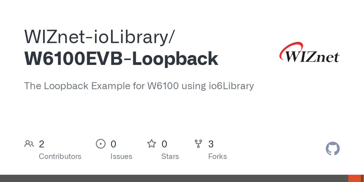

RE: W6100 evb programming
by taylor ·
Hello Mario_Runje,
Here is W6100 Loopback full code.
thank you
taylor
