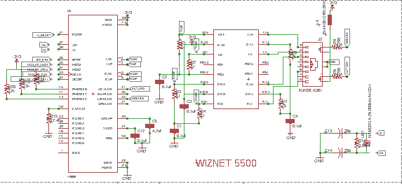

Circuit diagram and board picture please.
You have link bit set even when cable is not plugged in?
RE: can´t get link either
by Shaka ·
Hi thanks for your repply, this is mi circuit,
and Yes, i get PHYCFGR =
187, 10111011 without the cable.
Regards

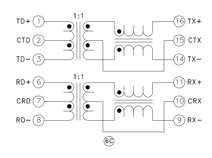

And this is the transformer squematic
würst 749010013.
thank you.
