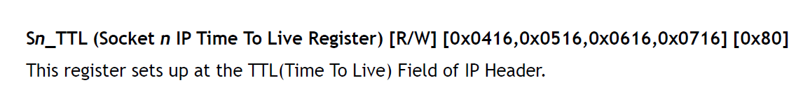

You can confirm the TTL information using Sn_TTL register.

So Sn_TTL register has TTL information from the last received IP packet? I talk about accessing TTL info for the packets being received, not sent. For example, to achieve task of tracing the route or assessing the distance to specific netowkring device.

In conclusion,Sn_TTL register is for sending packet. And the TTL of received packet don’t store .
If you need the TTL of received packet, I think you should be use MACRAW mode.
