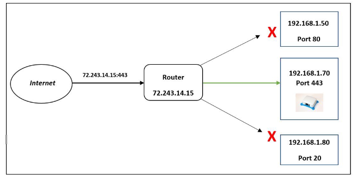

RE: DHCP IP address
Hi~
If another device needs to send data to your device, you should modify the setting of router.
And you should set the port of device in Port forwarding of router.
You refer the as below.
thank
BR
irina
