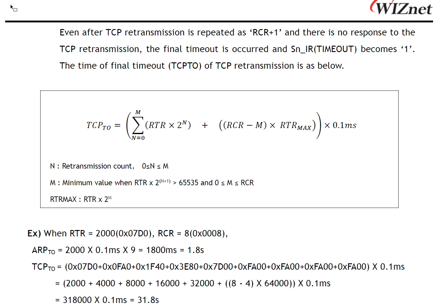

There will be traffic to the gateway, at least ARP requests. Only network log will show. Not sure but these 30 seconds may be a timeout for something (e.g. ARP request). Just a guess.
RE: Websocket Client stops receiving after a short period
by Mxyxixptlick ·
The 30 seconds does suggest a timeout. See the following from the W5500 datasheet.
