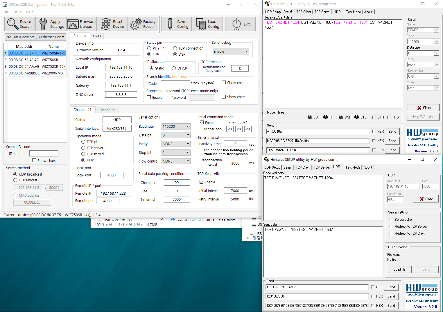

Hi grama
I tested your opinion.
We test was good. It was working.
please refer to below image.
Thanks
RE: RE: Serial Data not forwarded to LAN in UDP mode
by grama ·
Thank you for testing.
But could you re-run the test with the timeout between 50-100ms instead of 5000?
I have a small packet that will be sent. So I don’t want the Wiznet unit to wait for 5 seconds.
Grama
by Edward ·
Hi Grama
I already tested 50~100ms. it was working.
Please firmware re-upload in board.
After re-upload in board and If it is don’t work, please update to ISP mode using J7 connector.
