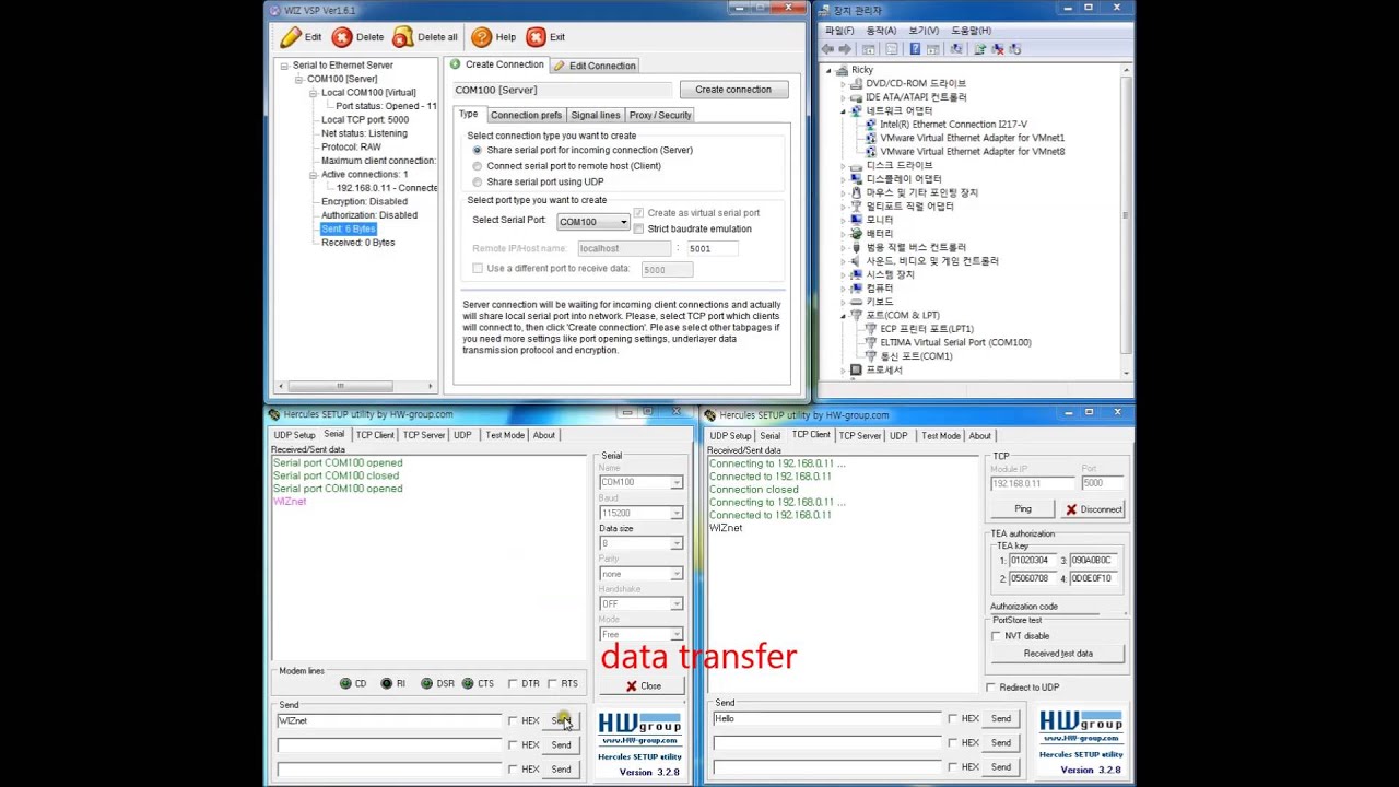

Hi Grace.
First, tell me your PC test environments such as window10 or 7?? and 32-bit or 64-bit??
Secondly, Run as an administrator to WIZVSP.
If it not work, please uninstall to WIZVSP. (You must use uninstall file to WIZVSP inside)
And you try to PC turns off and turn on again. Then reinstall WIZVSP use an administrator.
And refer to below link and file. It is WIZVSP user’s guide.
WIZ VSP_User_Manual_English.pdf (860.4 KB)
The operation things is refer to below explain.
You connect WIZ110SR to PC with WIZ VSP using LAN cable.
WIZ VSP is COM port(serial) to Ethernet converter tool.
So If you send to COM port with some data, this tool convert serial data to Ethernet data.
And IP of WIZVSP is your PC IP. and port of WIZVSP is 5000. Because you set 5000 port.
If you want connect WIZ110SR and WIZ VSP, you should connect to WIZ110SR(TCP client) to WIZVSP(TCP Server). Then It will be converted to COM20.
So, connect concept is (Serial port) – (WIZ110SR) – (Ethernet) – (PC with WIZ VSP).
Thank you
