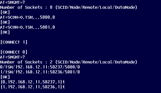

What about using a “open at once” mode?
I tested WizFi250 can create two socket server like below.

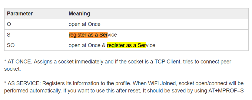

Then rise a question, what is the diffrence between “register as a Service” mode and "open at once” mode?
As linux developer I this first about register as a Service.
But maybe I wrong.
kzsolt2

RE: MULTIPLE TCP server
by kzsolt2 ·
Dear Tom!
There is the problem.
If I “register as service”, then I do not need to care for AP join or disconnect / socket connect and disconnect, Wizfi automatically open the socket server.
But if I “open at once”, then I need to monitor joined/disconnected status, and “open at once” every sucessfull AP join.
But there is more problem.
I can detect AP connection state by WSTAT polling.
But If AP restarted, then AP disapper just for short time.
For this case WSTAT polling is not works well.
This is why “register as service” is very helpful.
Moreover “open at once” open for just one connection.
If connetion are closed need to detect it and register socket again.
Best regards, kzsolt2
