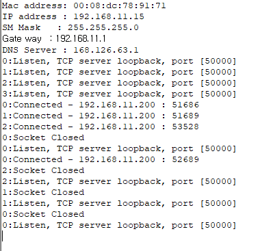

If you want to use the multiple listening TCP sockets in TCP Server mode(W5500), it can use it.
But the socket of W5500 will open the socket in sequence.

Thank you ! I am very new this board .So I have been searching for multiple sockets with one ip and multiple port . Can you explain how to wrote code for connection , i am also working on W5500 . But i want to make multiple socket objects by using one ip with multiple ports. I helpful for me ,Thank you .
