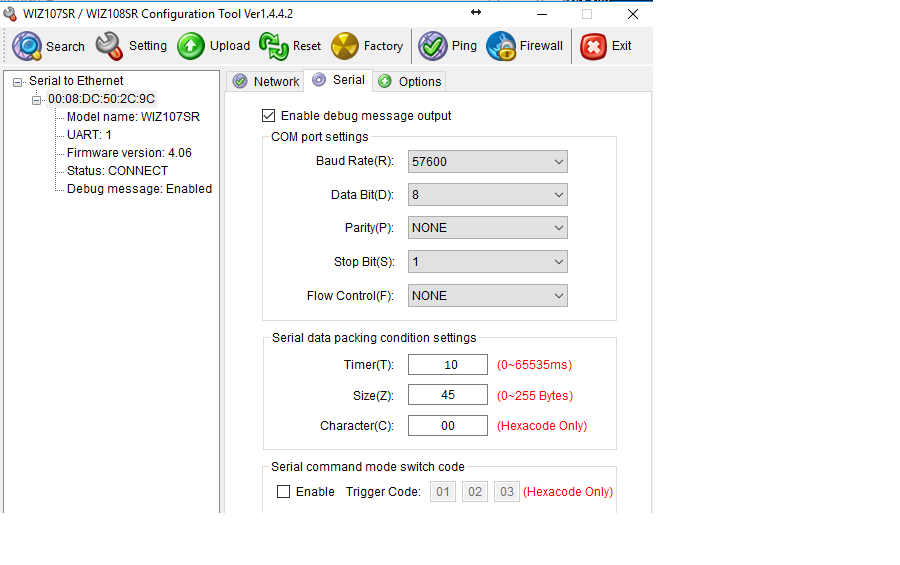

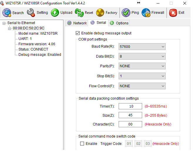

by Yaniv Reibenbach ·
the application is Location tracking readers, so we have small packets (15 bytes) and there might be a lot of them, even as many as 100+ packets in 1 second

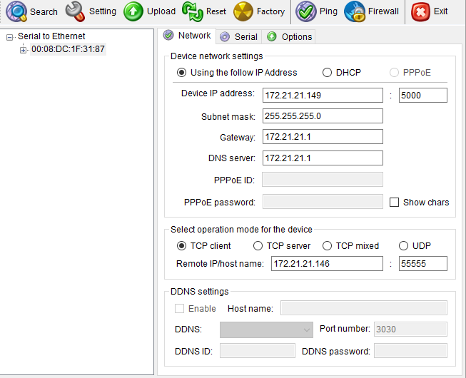

Hi
The modules are not responding to anything! not serial debug and are not found using the ConfigTool.
The uart is not transmitting any signals.
there is no ethernet data created and not visual viw wireshark
