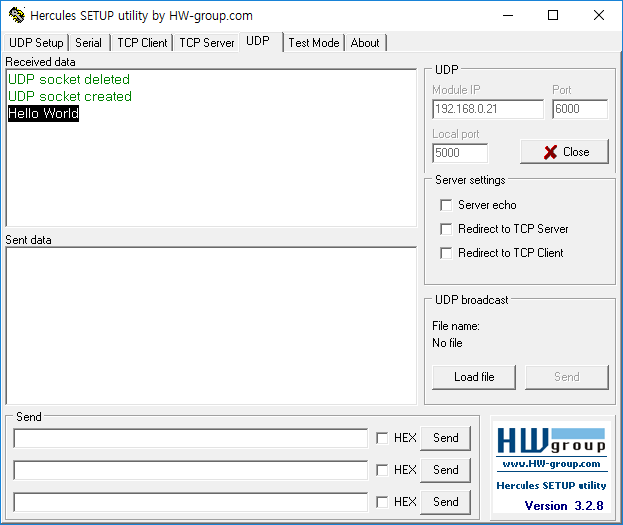

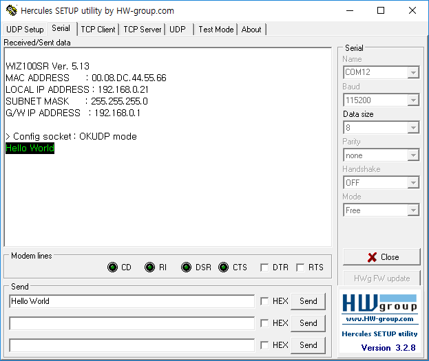

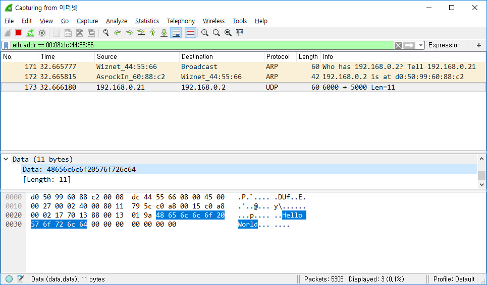

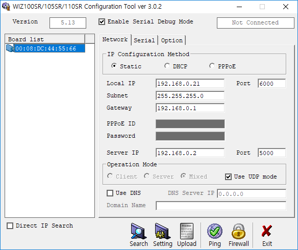

I don’t understand that socket is created with 161port.
This is the log of udp communication with v5.13 version.

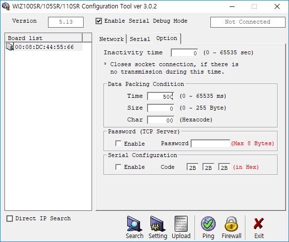

This can be the case when the module captures serial data and sends it to Ethernet.
To prevent this, set the option.
