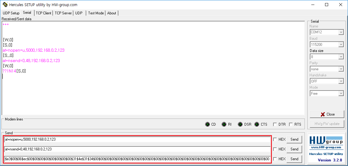

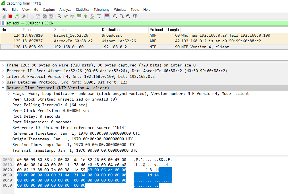

It is not difficult to add the NTP client in the module.
However, it is difficult in systems that convert serial to Ethernet.
For example,
How do you express the time you received with NTP? Will you add one serial port and print it?
There are many considerations.
So, I suggest you get the time information using the AT command. NTP protocol is simple.
See attached photo.
or You can modify it yourself. The source of WIZ550S2E is open at Github
