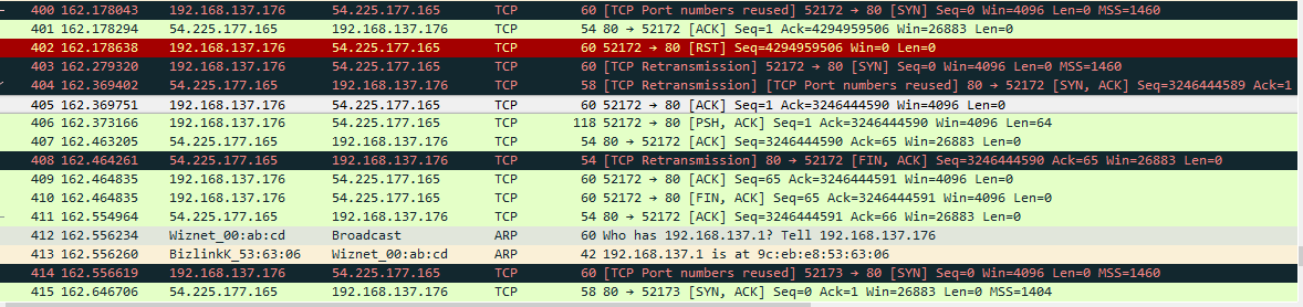

This is while on wireshark I can see TCP packets going both way.
192.168.137.176 is my wiznet 5100 ethernetshield on a nRF52840 (nordic semiconductor)
54.225.177.165 is the website I am sending requests to
Can you please help me with the library, I should note I am using the w5100. So in the httpClient.H I changed the board from w7500 to W5100.

Well I am little further with the issue.
It seems the request I am sending out is not correct:
Anyone have an idea what I am doing wrong, or another site that I can send HTTP GET to ?
