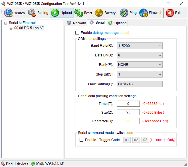

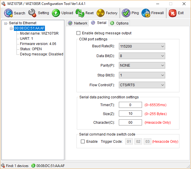

Please try to pack serial data by Time Packing instead of Data Size. You will then be able to see if the serial side data is normal or not.
