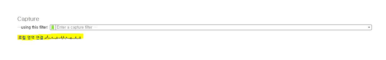

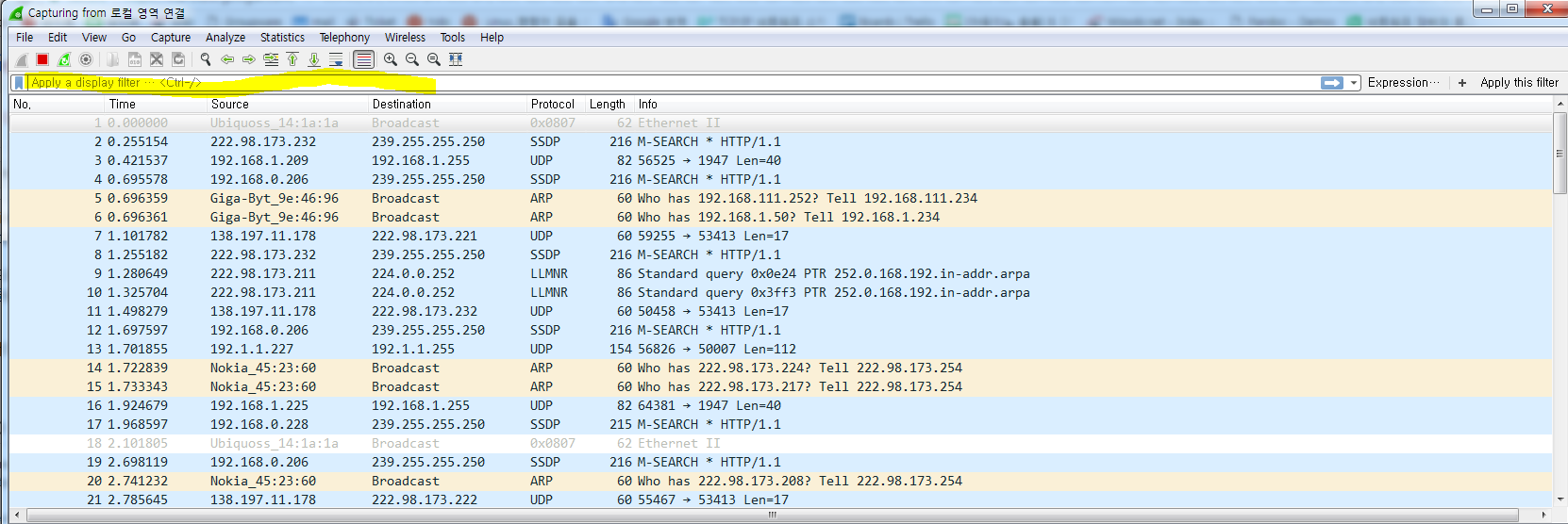

It would be better to check the packets with wireshark. Connect w5500 and PC to Dummy Hub and check on PC. You can download wireshark at Wireshark · Download and it is simple to use.
By clicking below, you can see all the packets sent and received on the network.
To see only packets that communicate with your server, write the server ip in the blank. (ip.addr = xxx.xxx.xxx.xxx)
For the connection to be successful, there should be a syn - syn, ack - ack packet. Only the syn packet will exist in the present situation. Check this out.
