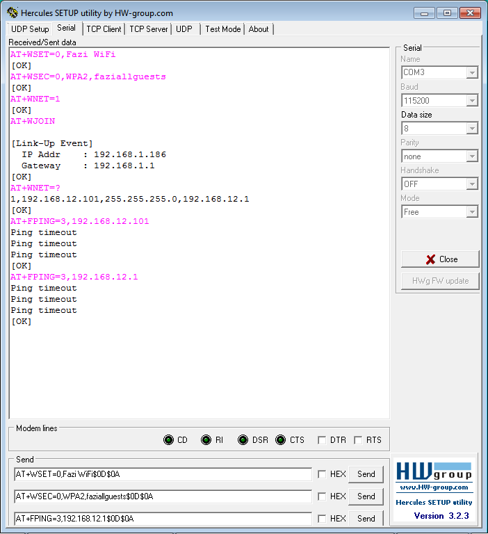

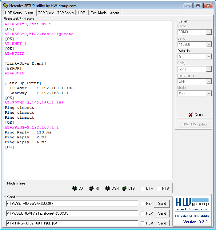

I hope I successfully attached an image. Here, I want to add that I soon found that pinging 192.168.1.1 works, and 192.168.1.186 does not.
I intentionally erased the first command after reset (echo suppress) in order for picture to have enough place to show communication strings.

I noticed my error- didn’t read the lines that say AT+WJOIN=? doesn’t return actual info (but rather from memory). Then I suppose my IP is 192.168.1.186. However it doesn’t reply to ping request. It seems that 192.168.1.186 is not my IP address, but I don’t know what it represents in string response. In that case how can I learn it (IP address) ?
Regards

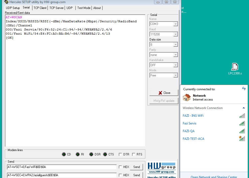

And I forgot to send screenshot of scanning process - module vs laptop.
Regards

If signal’s power is weak, it won’t be search.
< AT+FPING >
First, you should check the firmware version.
You can check and download a latest version in following.
http://wizwiki.net/wiki/doku.php?id=products:wizfi310:wizfi310firmware:start
Second, you should disable to firewall related with ping.
And then try it again.
Thanks, regards.
