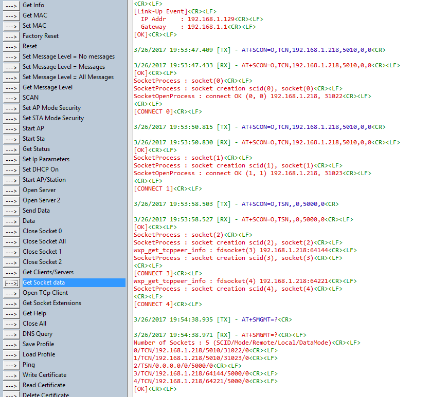

With reference to the attached image:-
When sending AT+SGMT=?
The reply shows the status of 5 sockets.
Sockets 0 & 1 pertain to the client and their type is shown as TCN
Socket 2 shows as a server and its state shows as TSN
Sockets 3 & 4 are the server connections but their state shows as TCN.
With 2 devices connected to the server the server consumes 3 sockets and shows 1 state as TSN and 2 others as TCN .
How is the user to ascertain the socket state with this command if its hows TCN in both server and client instances ?
