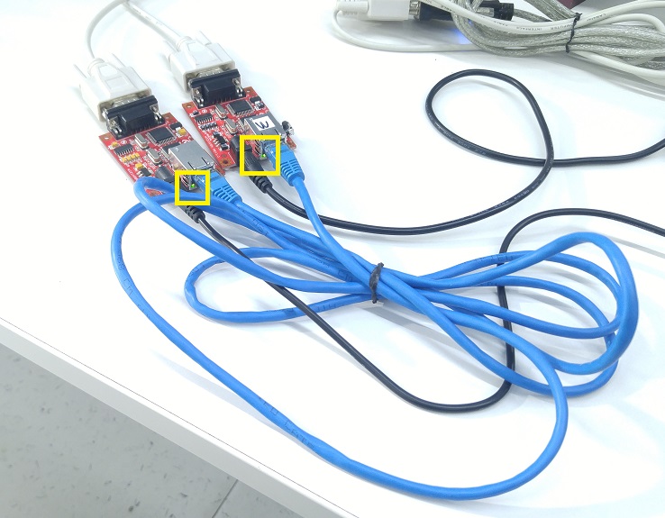

If it is correct, the LED is turned on as you see it.
I recommend that you change the cable or give some more information (photo etc).
To help you with your testing, share the environment I tested below.

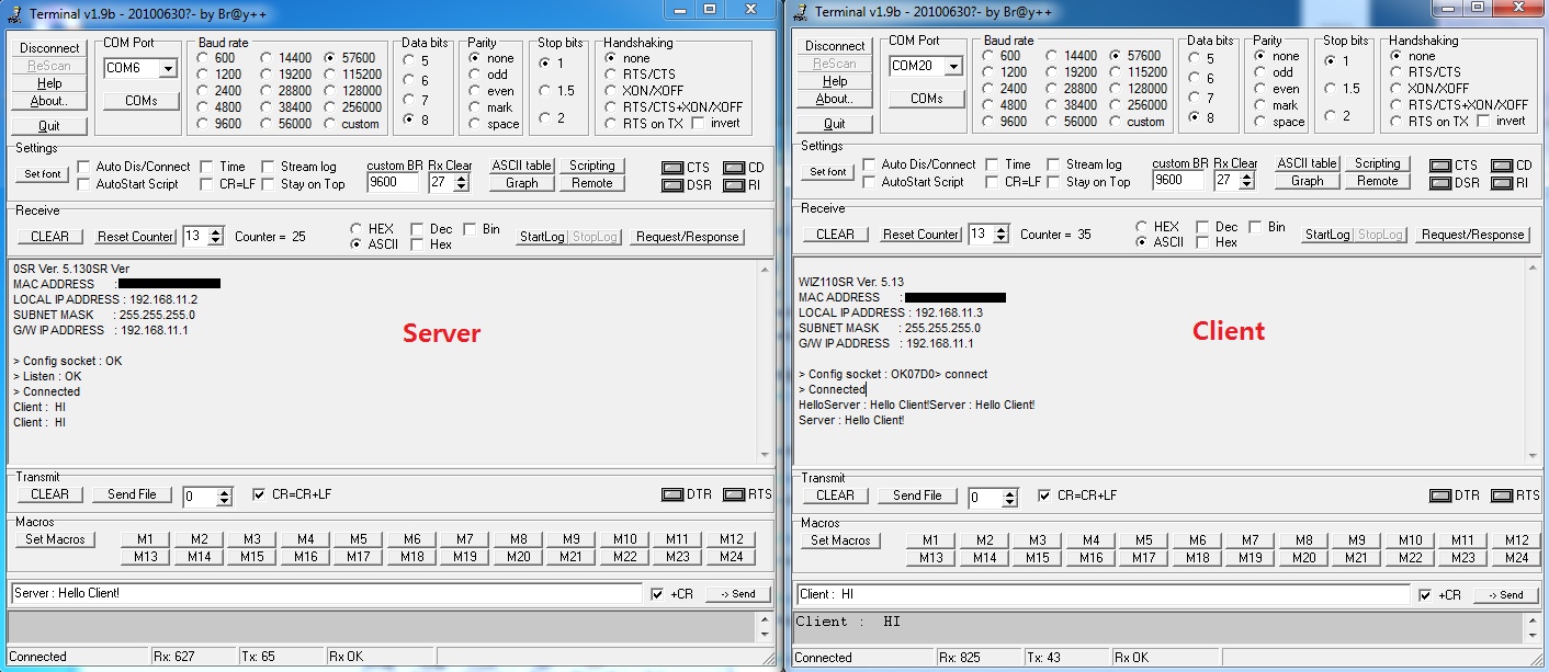

When two boards are A and B respectively, A is set to Server and B is set to Client.
If you enter server network information(remote address & remote port) in client, it will connect automatically when two devices are connected.
Of course, the local ip address of both boards must be different.
That is, the client must have a different remote ip address and local ip address.
You may already know, but leave information to emphasize once again.
And the picture below is the information and the results I tested.
I hope that helps.
