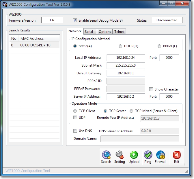

I have tested WIZ1000 such as your method.
But it’s normal.
LED of Ethernet Act is blink and a target is founded by CFG tool.

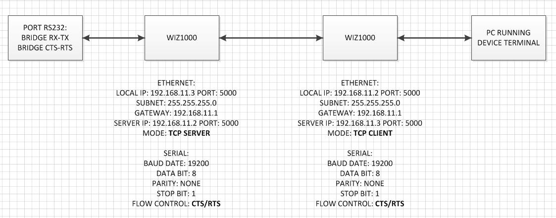

Just the next test, configured as shown below:

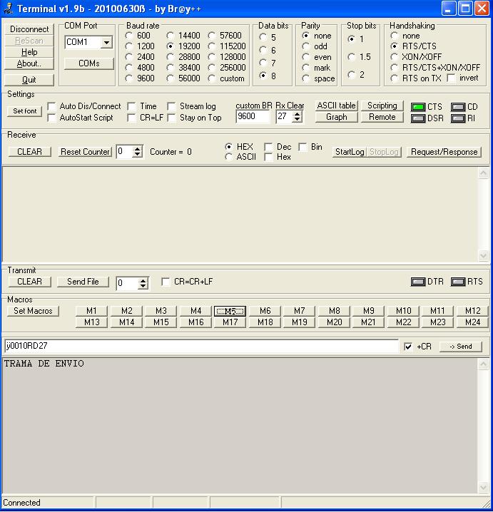

Before sending data to the terminal device, the modules are found with CFG.
After sending some data through the serial port.
No response data to the serial port. (Device Terminal).
CFG founded the WIZ1000 Client but not the WIZ1000 Server.
In WIZ1000 Server, the Ethernet Act Fix On. To find it again that you turn off the WIZ1000
