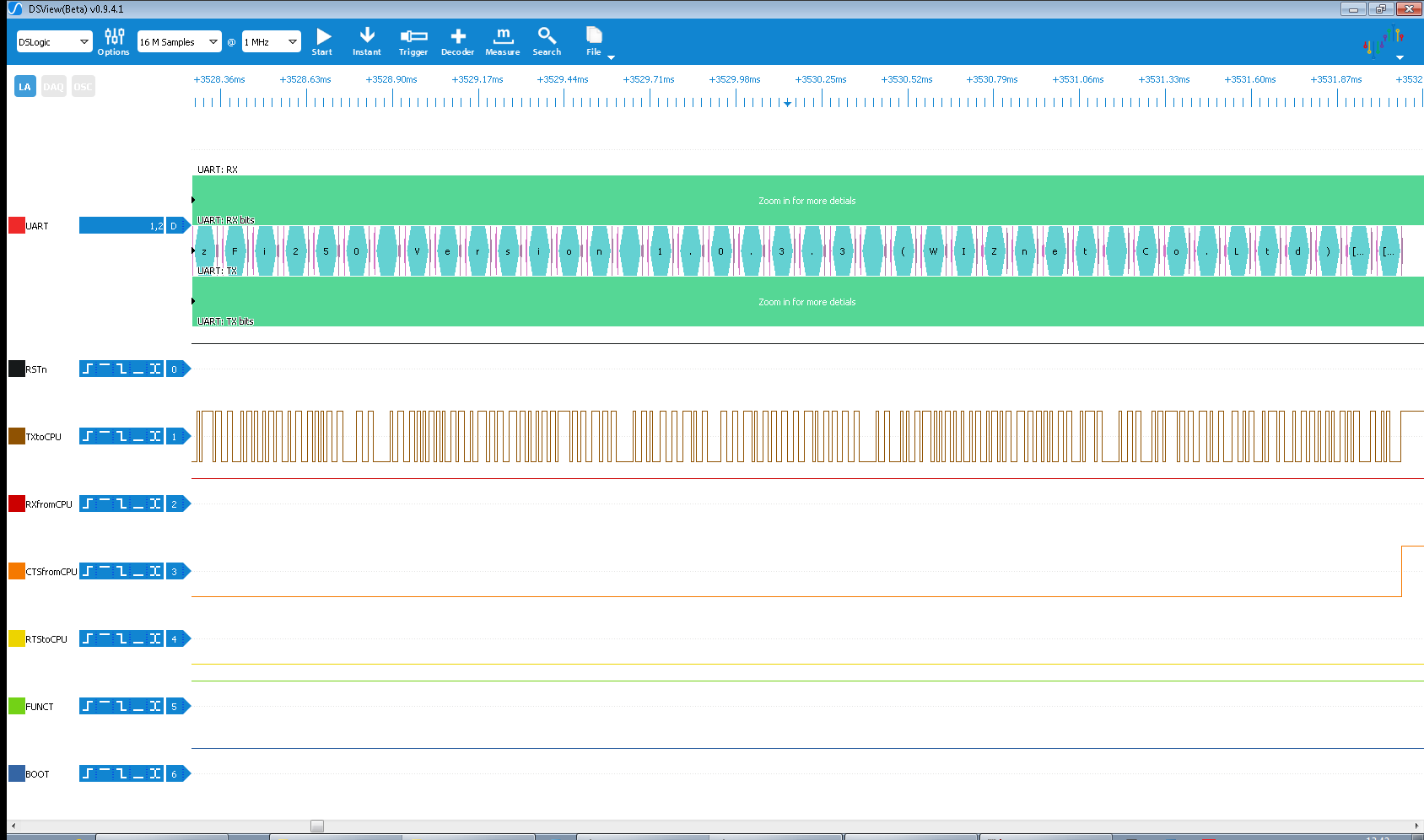

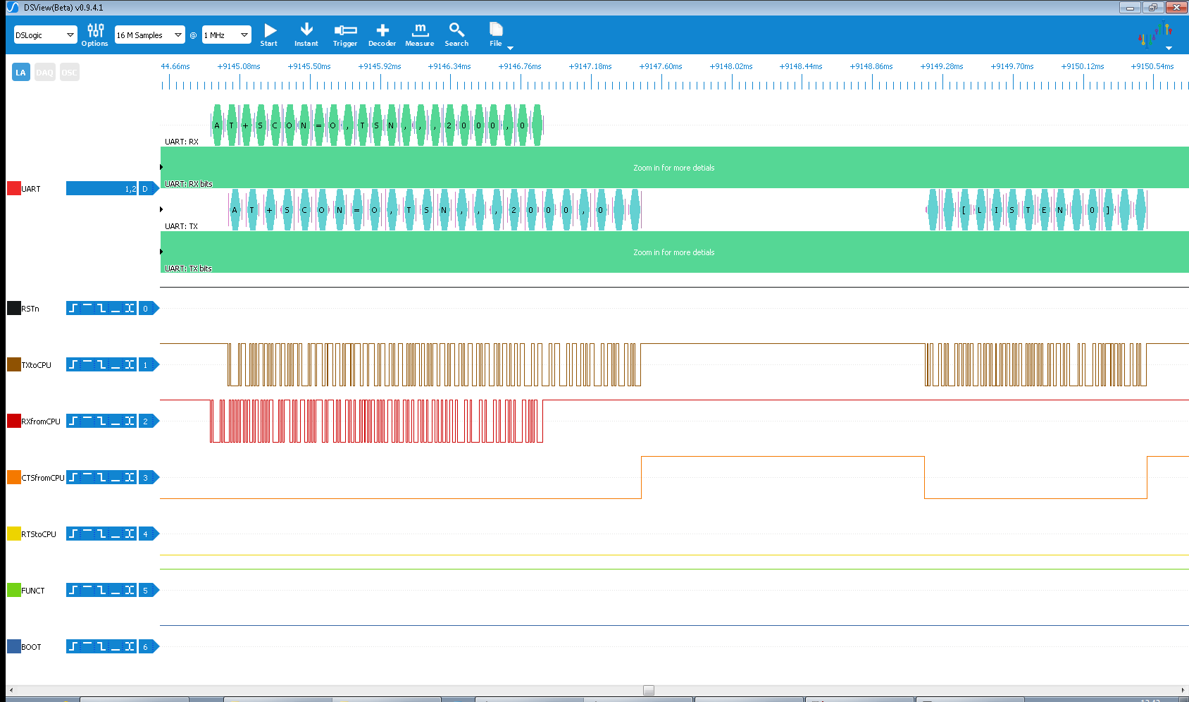

but i have do with my logic analyzer, a trace starting from RESET, up to open TCP server socket …
this trace show clearly
after RESET : 1.0.3.3 version
and after AT+SCON : [LISTEN0] message !!!
i have done several firmware switch and factory restore on these modules … maybe something is wrong during fw change …
but as i see, [LISTEN is present on this module which show 1.0.3.3 fw version !!
how can it be possible !?

RE: Can't start anymore a TCP server!
by phil31 ·
Wizdaniel …
the screen copy i provide, comes from the SAME logic analyzer capture !..
first pic show version 1.0.3.3 … then later, the [LISTEN 0] answer …
after playing a lot with all my boardw, i have 3 boards now that show 1.0.4.2 fw version and NO [LISTEN message after open TCP socket server.
