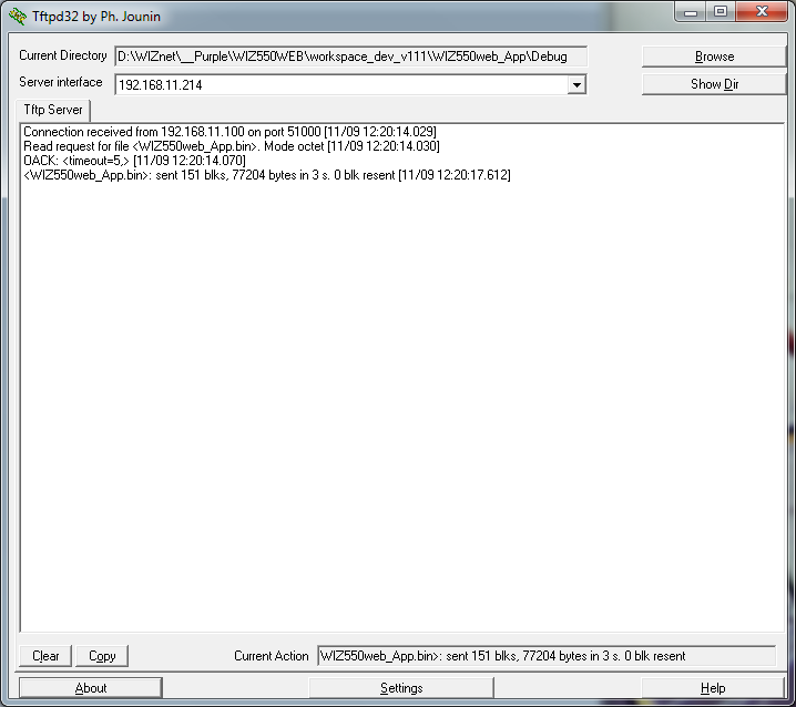

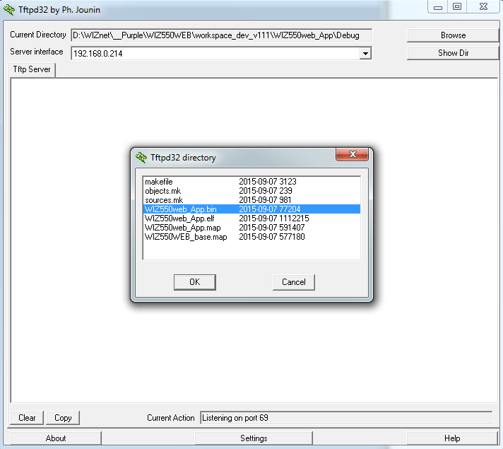

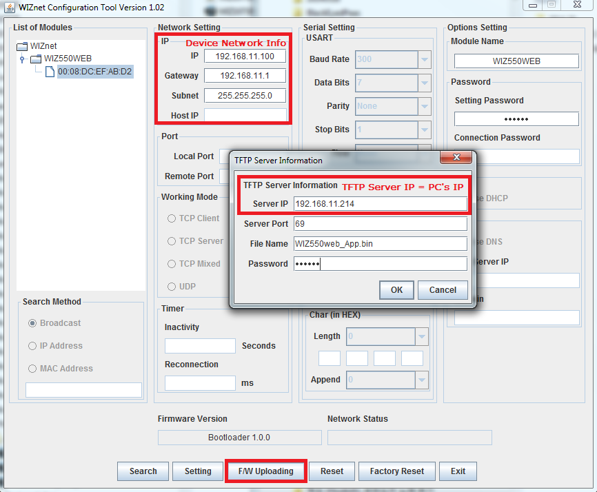

We are recommand the TFTPD32 program.
tftpd32.jounin.net/
Note that,
You should ensure that the other TFTP server programs are occupied the port 69.
Following the next steps.
Upgrading the WIZ550web device’s firmware using the WIZ configuration tool:
I’ve attached helpful captures for you. Please refer to the this capture images.

TFTP server IP address was set to the PC IP address, because TFTP server was started locally on the same machine as the configuration tool.
