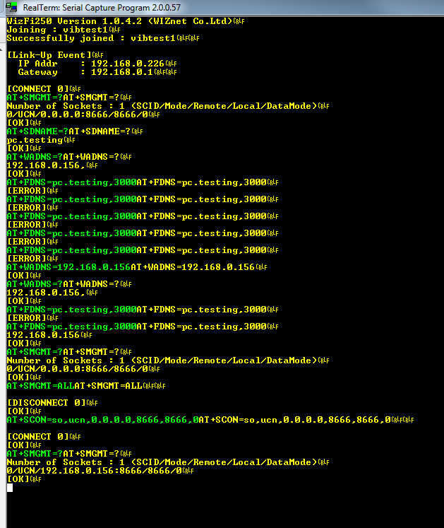

Yet still I have a problem, the remote IP is not correctly resolved after reboot, (it gives 0.0.0.0)
and so connection does not work. I investigated further :
I think the difference between your test and my test, is that I use a custom DNS server.
This was set with AT+WADNS=192.168.0.156 and saved in the profile.
But after reboot it seems to remember this value but NOT use it.
Please consider the screenshot with log below :
At first after reboot, the DNS queries have no effect, they do not come in on my DNS server.
It is only after I set AT+WADNS=192.168.0.156 again that the DNS request is really executed.
I can see in the log of my DNS server that all attempts before setting AT+WADNS=192.168.0.156 again
do not request to my dns server. Immediately after setting AT+WADNS=192.168.0.156, the following DNS requests all reach my dns server.
For some reason the first gives an error on wizfi and the second succeeds.
After that I can make the connection correctly and communicate as intended.
Please have a look at this log, it shows the problem :
I tested this flow 5 times, even waiting 10 minutes after bootup. Always the same behavior, I need to set AT+WADNS=192.168.0.156
again to make it work.
Kind regards
Serge
