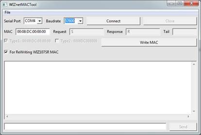

It is MAC ADDRESS erase problem.
It is don’t have MAC ADDRESS.
So, Writing MAC ADDRESS in WIZ107SR Moudle.
There is MAC ADDRESS number Sticker on WIZ107SR Module.
After a few days we give you MAC ADDRESS Guide

MAC ADDRESS Re-write steps.
(WIZ107SR has its own MAC ADDRESS)
WizMACTool.zip (6.83 MB)
a postscript = If can’t see COM PORT in Serial Port, Then This field click and push upper&down keyboard.

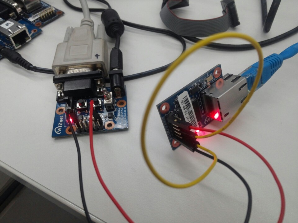

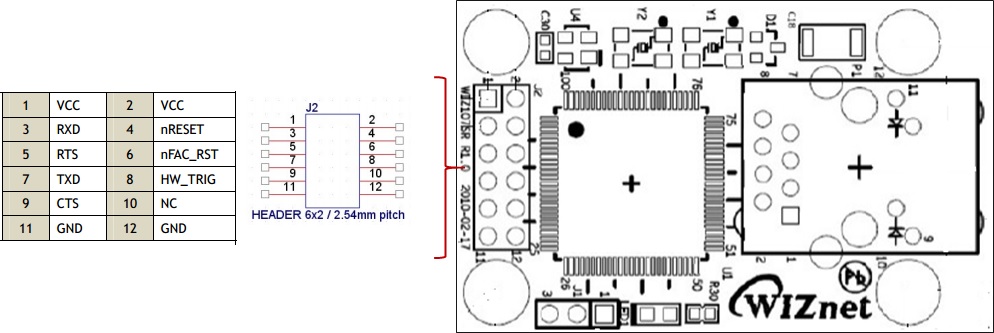

Can you please explain step 0 (Switch on the H/W Trigger in EVB).
What are all the pins should be connected and to which voltage these pins should be connected.

There is H/W Trigger pin in WIZ107SR moudle…
you have WIZ107SR + WIZ107SR-EVB ?

Hi, sravanthi.
H/W Trigger pin is active LOW. The Step #0 means that H/W Trigger pin (Pin 8) connect to GND.
