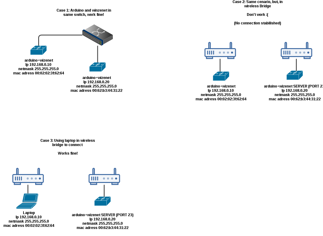

See the current scenario:
I suspect “IP FRAGMENTATION”

by justinkim ·
If there is a problem in the source code, I think IP issues.
Laptop is can be holding a many IP. but W5100 shield is holding a single IP.
So You must check the Router IP. Each Routers must have the same Network.
