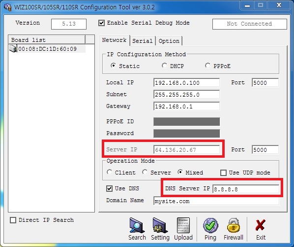

Hi.
I’ll investigate your question.
I think this is related to a configuration tool display.
If you insert the correct DSN Server IP and select the Use DNS checkbox, you can use a DNS function.
Refer to the following image.
Thanks

Dear Markino193
You can get the latest firmware from the following site.
wiznet.co.kr/sub_modules/en/ … F_KeyWord=

by Markino193 ·
Thanks a lot, now it works fine.
