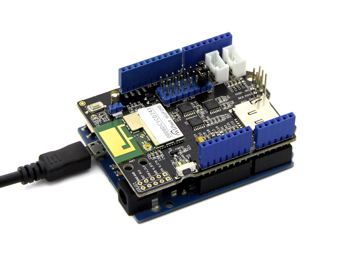

RE: Error : Timeout or Not Found Success String
by vova ·
From what I’ve understood from the tutorial, I need to reset the board (by pressing the function button three times) and then connect it to the arduino and the board will switch into SPI mode. Is that correct? I’ve tried doing that and got the same result.
Also I’m using the WizFI250 shield (not the WizFI250-EVB) so I don’t have the exactly same button layout as in the tutorial, and I can’t connect the board directly to my computer and read what it’s saying.
by vova ·
That indeed explains a lot. Thanks!
