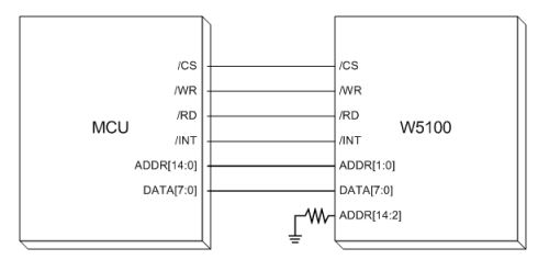

For the communication with MCU, W5100 provides Direct Bus I/F, Indirect Bus I/F, SPI I/F mode.

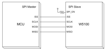

Direct/Indirect BUS I/F → each time a byte is transmitted.
SPI I/F → each time a bit is transmitted.
