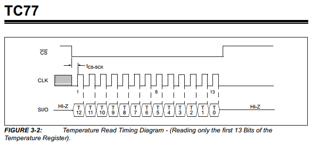

Thanks partner :mrgreen: , This is just a logic stream of data from the TC77, I dont have it plugged into the 5500 yet
, not sure where the wires and data would go in the 5500? I know where the TC77 goes on the chuck wagon

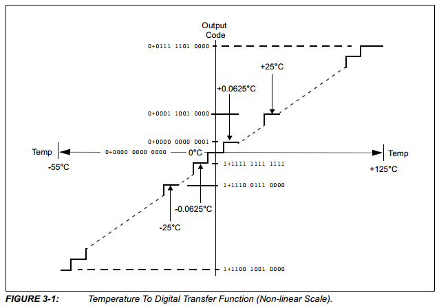

The first 13 bits of the 0x0D 0xD7 represent 0000110111010 or decimal 442 which is multiplied times the TC77 resolution of 0,0625 deg C so its reading 27.625 deg C here on the ranch today. But thats what I want to go into the 5500 so I can read it on my internet. does that clear up what Garbanzo is trying to do?
