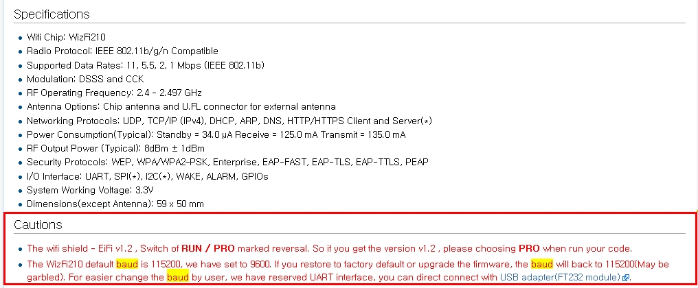

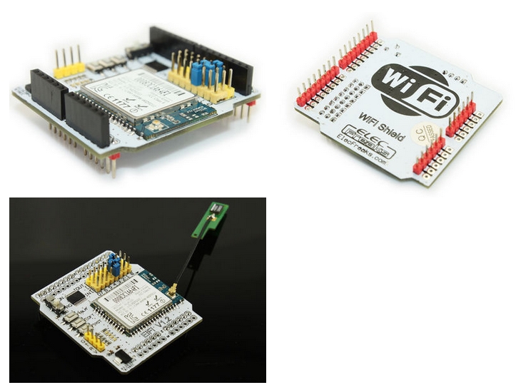

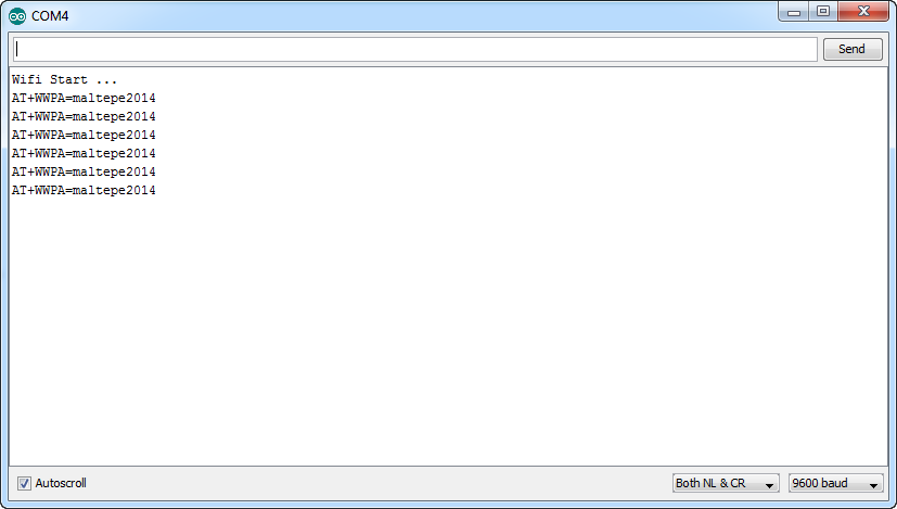

Hi ,
My problem is my arduino and eifi wifi shield(wizfi210) not communicate each other.I try own page code (elecfreaks.com/wiki/index.ph … eld_-_EiFi) and not working.
it continues …
I have tried :
wifi shield pin DOUT-D2 , DIN-D3. arduino code tx-pin 2 rx-pin 3 , use software serial lib.
[code]#include <SoftwareSerial.h>
#define rxPin 2
#define txPin 3
SoftwareSerial mySerial(rxPin, txPin);
void setup()
pinMode(rxPin, INPUT);
pinMode(txPin, OUTPUT);
mySerial.begin(9600); // setting baud to 9600
Serial.begin(9600);
void loop()
mySerial.write(“AT\r\n”);
char rcv;
if(mySerial.available())
rcv = mySerial.read();
Serial.print(rcv);
delay(1000);
}[/code]
I use this code result " ÿ " char . What does it mean ?
Where is the problem ?

Hi
I am sorry for late reply.
I think it is problem in order to baud rate setting of WizFi210.
Frankly speaking, This shield and library is not made by Wiznet.
So I recommend you to ask to ELEC Freaks. Maybe there give more correct answer to you due to make library and shield by them.
