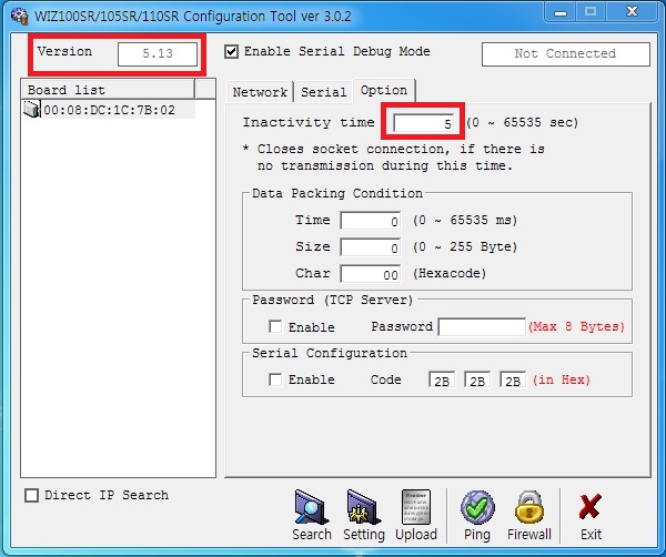

Dear geminitro
Please check the firmware version in Configuration tool.
And I recommand F/W update to 5.13 version.
Refer to [url]http://www.wiznet.co.kr/product-item/wiz100sr/[/url]
One more, I suggest to use inactivity time as 5~10 second.
