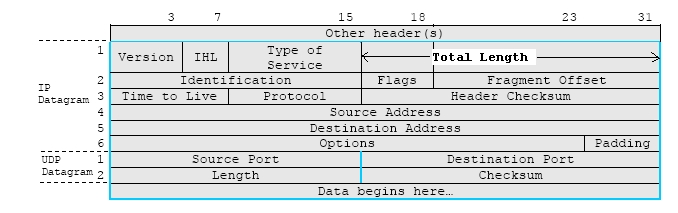

Hi
I have some questions.
What is mean of the specific port number?
What is mean of raw UDP message?
RE: Sending data to specific IP address using TCP or UDP
by jkellar ·
and 2. Yes, by specific address and port I mean for example 253.122.33.3 at port 8131
Yes, by raw UDP packet that’s exactly what I meant. That’s what I thought, the WIZFI630 cannot give access to that low level protocol. So essentially to make use of UDP, or TCP for that matter, a higher level protocol is required for the WIZFI630 such as TFTP, HTTP, FTP, etc…
