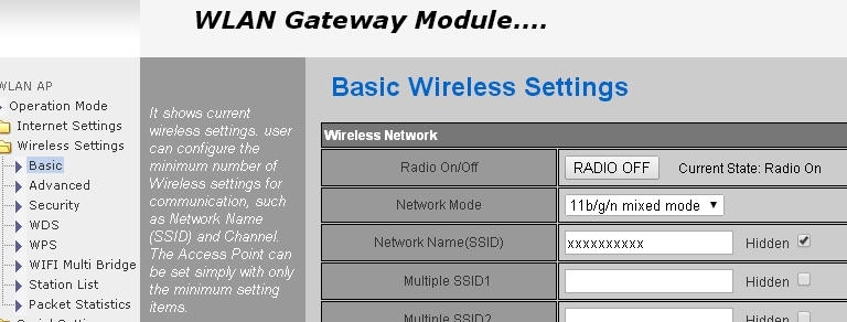

I just tested it as below
via web
It worked well as below.
via serial command
<PU7_3_10_0_12345678>
<PIWiznetKaizen_12345678>
After rebooting, it worked well, also.
