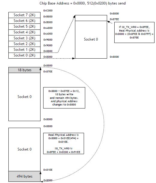

Dear customer,
Thanks for your interest in W5200.
W5200 don’t support a way to clear the buffer.
The only way to remove previous value is to overwrite it.
RX memory and TX memory are identical.
Please refer to as below.
