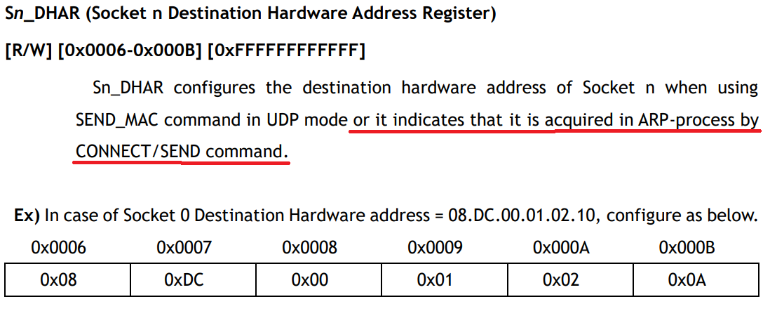

Can udp client got server MAC?
RE: Can udp client got server MAC?
Good question. There seems to be no way to know MAC address from the received packet, but when you send UDP packet back to the target IP you’d get MAC address in the DHAR. So after your
sendtoyou can obtain the MAC address, but not before it.RE: RE: Can udp client got server MAC?
by role 2099 ·
Many thanks! ARP can slove it.
