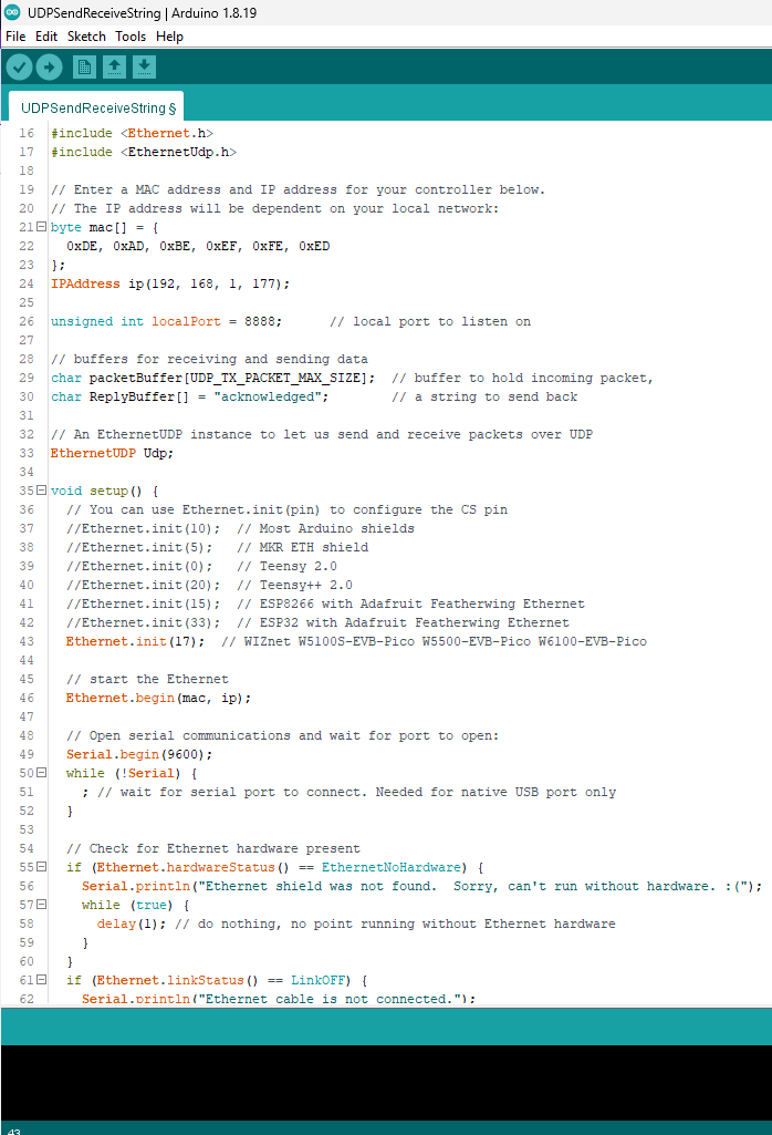

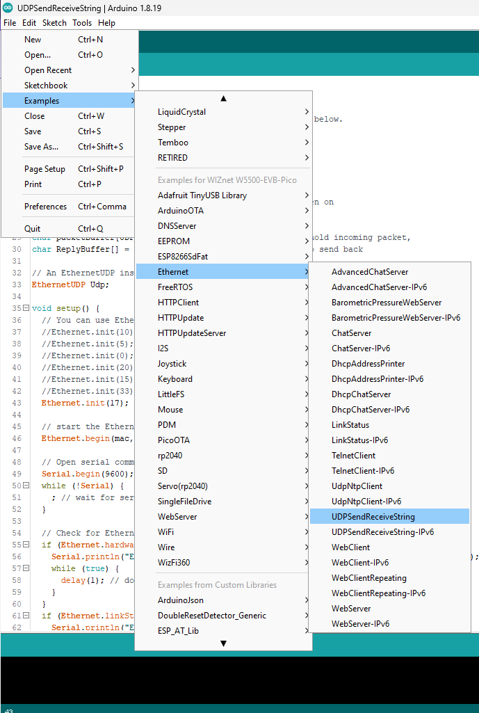

DHCP is UDP communication that requests an IP from a DHCP Server. It would be a good idea to first check if your PC and UDP are normal.
There is an example of basically sending and receiving data using UDP in Arduino. Run this and check if the network status is normal first.
