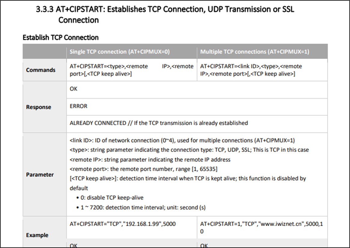

Hi @Sushma_N_S
When connecting to the server as a client, use ‘AT+CIPSTART’ and enter the IP and port of the server to connect to the server.
Please refer to the document below for details.
RE: RE: establishment of TCP client and server between two wizfi360 module
by Sushma N S ·
Hi Team,
Thank you,
From 2nd document, which is posted in the previous response was helpful me to connect.
Now I could have connect between two wizfi-360 modules in a TCP layer and can communicate between two by sending and receiving data.
