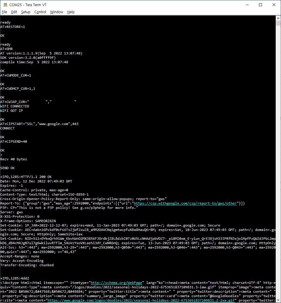

Hi @msemegen
I don’t understand what the problem is.
I simply tested ‘www.google.com’, but no problem was found.
Could you check it again?
RE: RE: 301 Moved Permanently
by msemegen ·
You are right. My HTTP request was faulty. But I have additional question: I don’t see if You put request content after AT+CIPSEND command. Request is created automatically by the module?
Best,
Mateusz
Hi @msemegen
After AT+CIPSEND=40, the data was sent as follows.
I sent the data like this for a simple test, so please refer to it.
