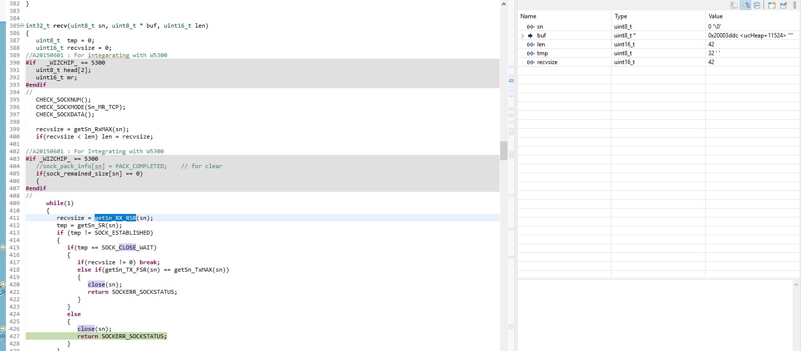

I have debugged a bit in the w5500 library code and discovered that the socket is closed in recv() function because the return of getSn_SR(0) suddenly appears to be SOCK_CLOSED (line of code 426). RX buffer is for sure not filled up because the value of RSR is 42 in decimal. Do you have any idea on what I could do next to discover why status register of socket is sudenly of value SOCK_CLOSED in recv function? Which registers would you check?
