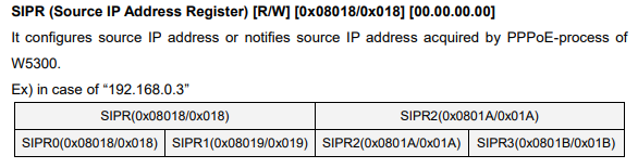

W5300 can't change up address
RE: W5300 can't change up address
by louis ·
SIPR has two register addresses. You can check the address by writing and reading the register on each of SIPR and SIPR2.
