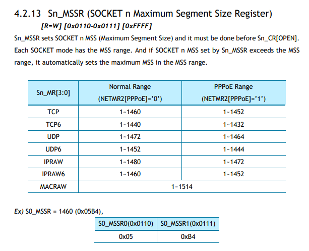

I doubt your interface is working. Please check the read-only registers such as version. Or, check the register address again.
Because in the case of S0_MSSR, the value is not set to 0.
RE: RE: W6100 MSSR unwritable
by Elie Assaf ·
In the table, it’s said that the Reset value is 0x00, and in the description it’s said it’s 0xFF.
I’m reading and writing successfully on other registers, testing MACRAW. It’s working.
