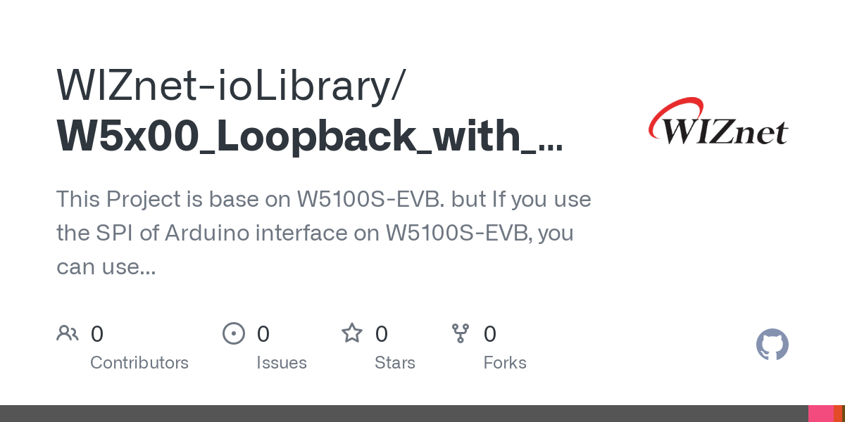

I think you should refer to the link below.

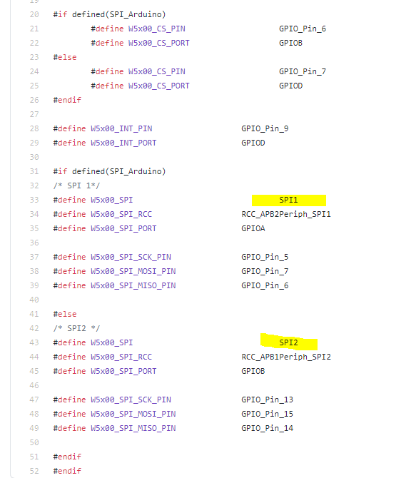

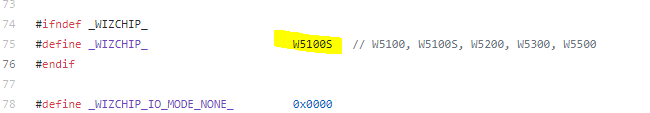

There are several areas in wizchip_conf.h.c and HAL_Config.h that need to be fixed or checked.
You need to check the SPI Pin map(in HAL_Config.h) and change the WIZCHIP value to W5500(wizchip_conf.h).
