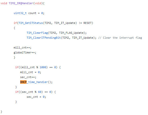

=> Timer handler
I think you have to check the operation of dhcp_tick_1s.

Hi @irina_kim
Thanks for your reply. I think, I resolved it, made some FreeRtos task related configuration changes and also changed logic for DHCP_time_handler, still testing. But now I have one more issue, it breaks the HTTP after renewing the DHCP lease. So do you have any idea which specific part to check for this issue? Do you think I have to close the socket before making the DHCP renew request?

RE: RE: STM32+W5500 DHCP ReRequest
My answer to the question is no. As far as I know, DHCP renew request packet should be sent before DHCP lease time.
if DHCP lease time is 1 hour, it would be good to send the packet at about 50 minutes, much earlier than that time.

Hi @irina_kim
Thanks for your answer
I found solution, there was a problem with DHCP_IP_LEASED case and web server start/stop flag.
So my mistake was to enable the web server flag before receiving the DHCP_ACK for REREQUEST, enabled it after receiving the DHCP_ACK and it works. Still breaks sometime, after 1 or 2 hours and sometime longer so looking into it.
