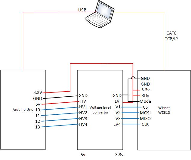

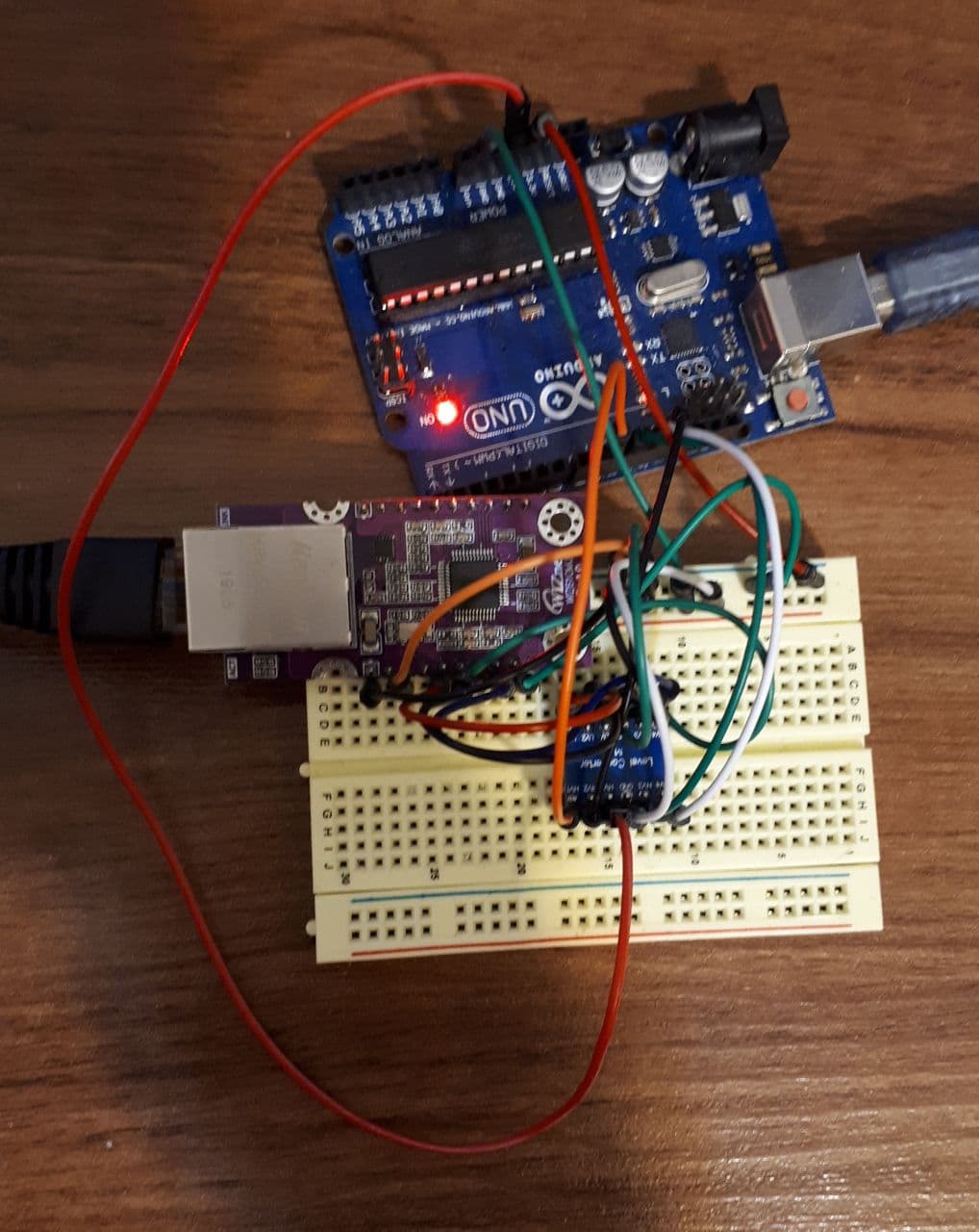

Hi Thank you for your reply,
Actually I have followed the structure you sent, unfortunately still have problem. When I run Chat server example in Arduino IDE, Wiz610MJ module could not get correct IP ,it shows: 09:50:58.689 → Chat server address:255.255.255.255. I have checked SPI connections but still same problem
RE: getting started by Wiz610MJ
I think there is a problem with your SPI.
Please tell me the hardware environment and Arduino Code.
by sbehnam3 ·
Actually, I am using arduino uno library which in introduced in the PDF file that you sent me.
I have tested the chat server example (also more examples) but module can not get IP. attached files show my setup and diagrams of connections.
