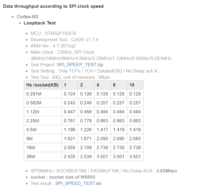

I think it would be good to refer to the picture below regarding SPI speed.
