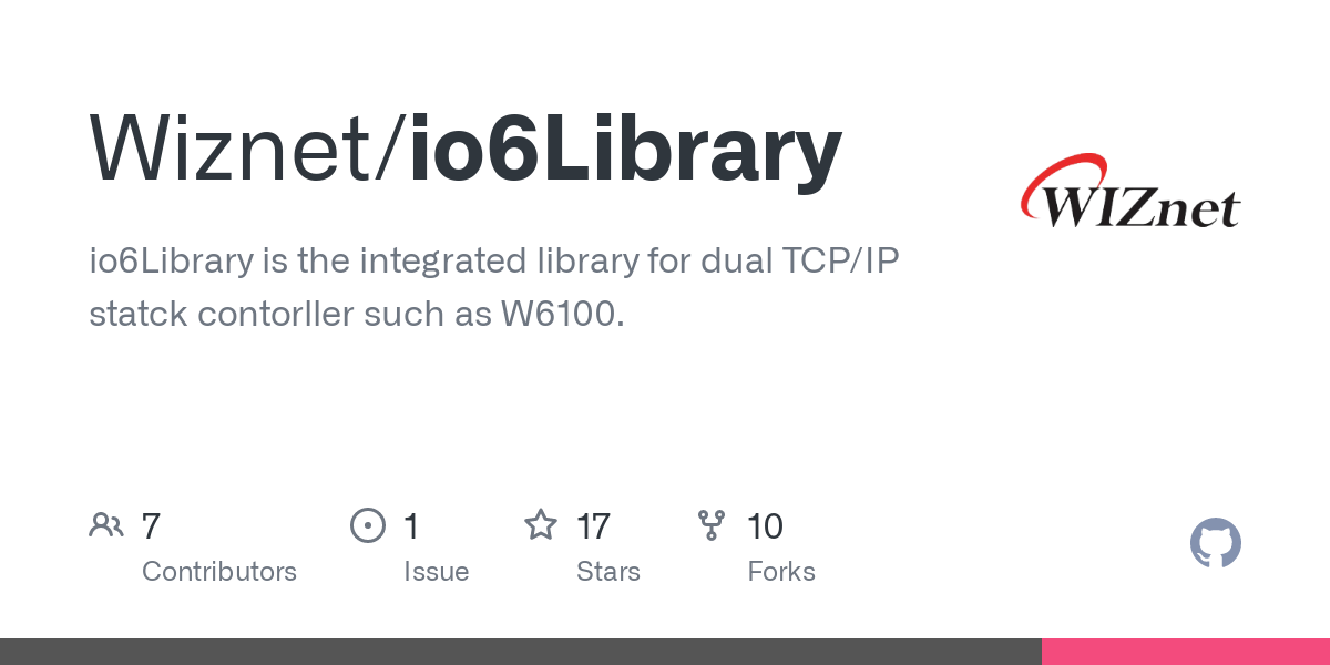

Sorry, we not support the project for 8bit MCU,
If you want to use the 8bit MCU, you can use the io6library and it adds in your project file.
