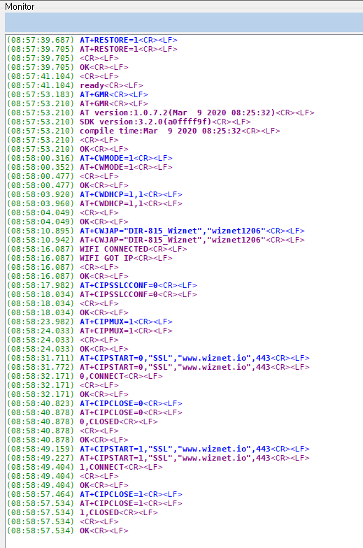

Can you tell me how to test the SSL connection? (AT Commands, Domain and port)
I tested the SSL connection to our site www.wiznet.io.
that was normal.
Please refer to below picture.

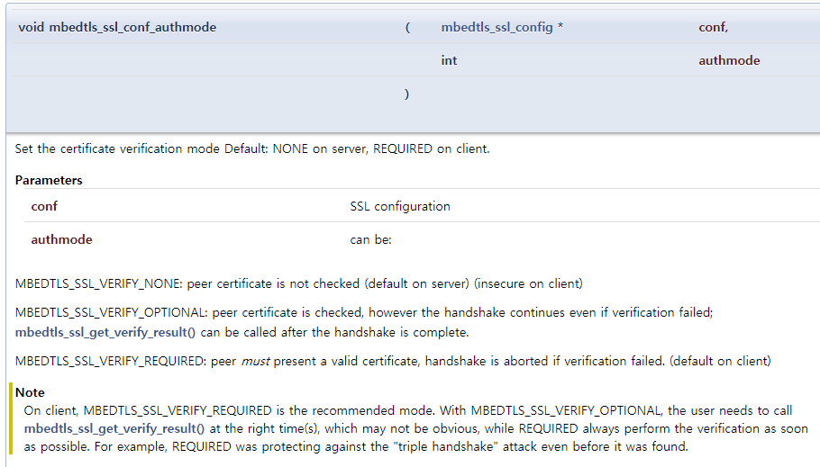

Our AT+CIPSSLCCONF command operates as mbedtls_ssl_conf_authmode.
0 : MBEDTLS_SSL_VERIFY_NONE
1 : MBEDTLS_SSL_VERIFY_OPTIONAL
2 : MBEDTLS_SSL_VERIFY_REQUIRED
so if you want to use 1 or 2 option, you have to input ROOT CA of server.
You used the MBEDTLS_SSL_VERIFY_OPTIONAL but your module didn’t connect to google.
I think, That because your module didn’t have Root CA. so Error occurred at x509 parsing.
The WizFi360 can be input through AT+CASEND Command.
