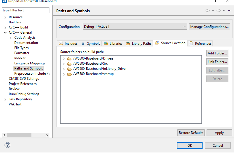

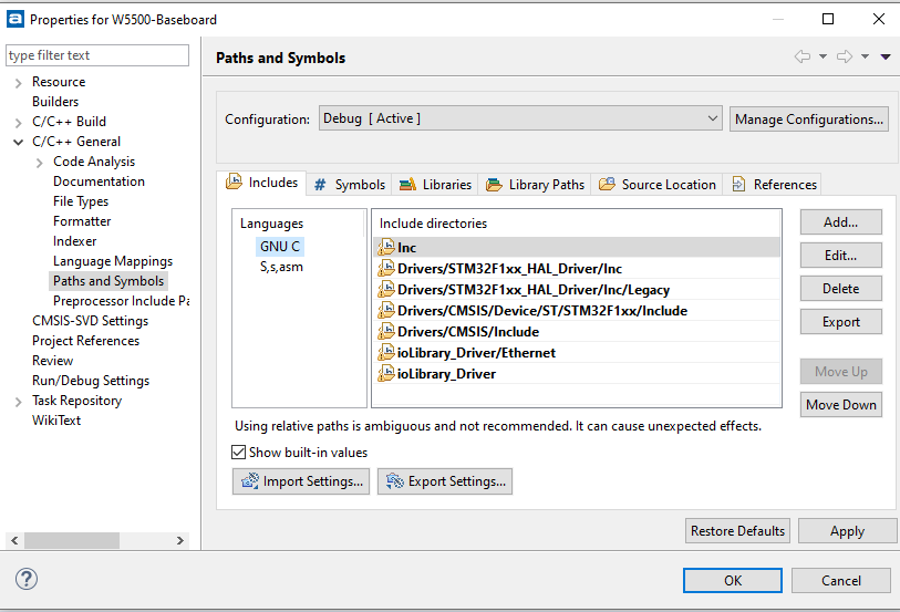

In case of Truestudio, i need to add include path as below. So please look for these settings.
