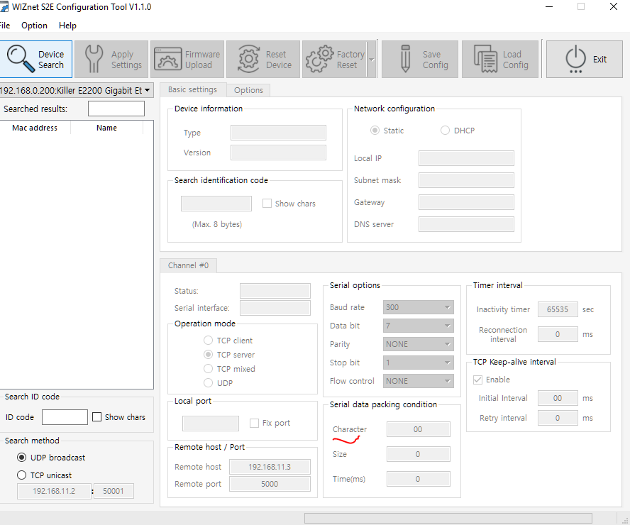

I think you should use the Serial data packing condition(character) in the configuration tool.
Serial data packing condition(character) :

Thank you for your prompt reply. Unfortunately this doesn’t work in my situation.
The main logic is right. The condition for the termination character assumes the stop character is received at the end of the packet, which isn’t right.
My situation (MAVLink protocol) uses termination character at the beginning of the packet. So I need to change the condition of this character from end-of-packet to beginning-of packet.
I have no possibility to use the packet length field as my packets vary from 10 to 130 characters. The only usable designator is the start character (0xFE).

I think we can’t apply the contents with the firmware that is currently provided.
We need to create new firmware for that protocol, which can be costly.
