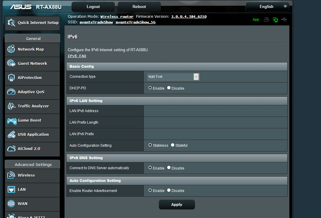

Thanks for the reply, and the advancedChatServer works for me. However, when I am trying to use WebClient example, the program stuck at “Initialize Ethernet with DHCP:” , and I could not see the device in my router list. I have switched to a router that supports IPv6, and the setting is as follows:
I just checked and found that even though the advancedChatServer works for me, I did not see the device in the list of router either.
Please advise what is the possible cause of the problem. Also, I am also wondering where I can find a example of TCP client example using IPv4 for the shield.

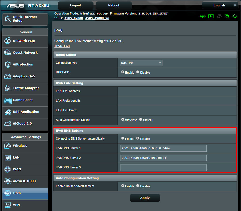

first you need to check ipv6 working with pc.
set ipv6 in router and connect pc to router on ipv6.
you can check if ipv6 is working or not with this website https://test-ipv6.com/ .
If router’ ipv6 works, all test will be passed.
if it is not passed, you can set ipv6 dns server manually
after that, try again ipv6 dhcp then share it.
